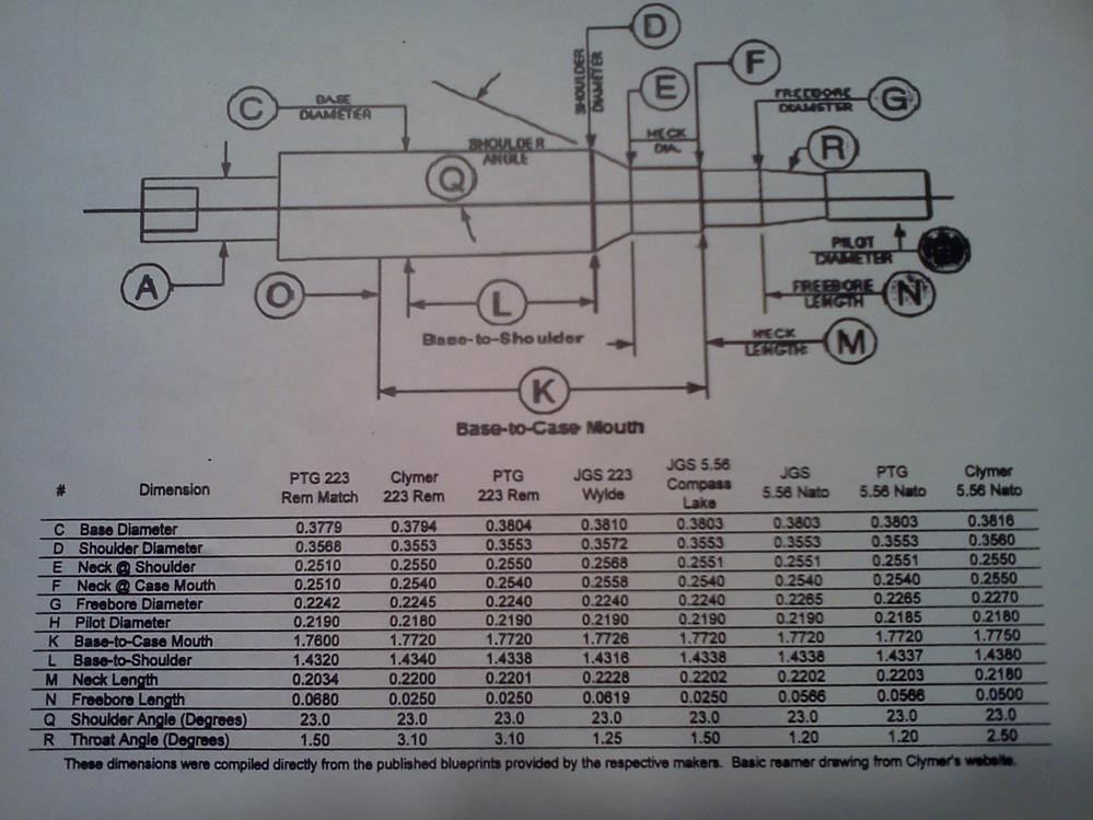

At one time I had a drawing that indicated a .002 (or something really small) only in the neck length IIRC. Can't find it...
I'll bite.
Base diameter 223. 0.3760 . 5.56 0.3780
Shoulder diameter. 223..3553 . 5.56 0.3560
Neck-2/Case Mouth. .223 0.2540 5.56 0.2550
Freebore diameter. 223 0.2245 5.56 0.2270
Base-to-case mouth. .223 1.7720 5.56 1.7750
Base to shoulder. .223 1.2340. 5.56. 1.2380
Neck length. .223 0.2200. 5.56. 0.2180
Freebore length. .223. 0.0250. 5.56. 0.0500
The throat angle is also off by 0.6 degrees

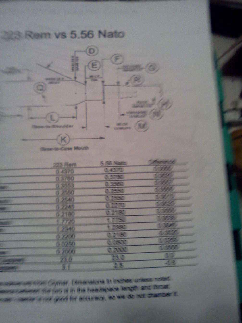

Here you go. I think whoever snapped that first photo may have a nervous disorder as bad as mine. :p
Attachment 1841
Attachment 1842
Uhh.... excuse me Sir... those are CHAMBER specs, I posted those and gave them to Rumbler some time back.
BRASS... the question was whether or not there was a difference in BRASS not the CHAMBER...lol.
Other than minimal case wall thickness... .223 Rem cases and 5.56 NATO cases are identical, only the CHAMBERS and load pressures are different.
