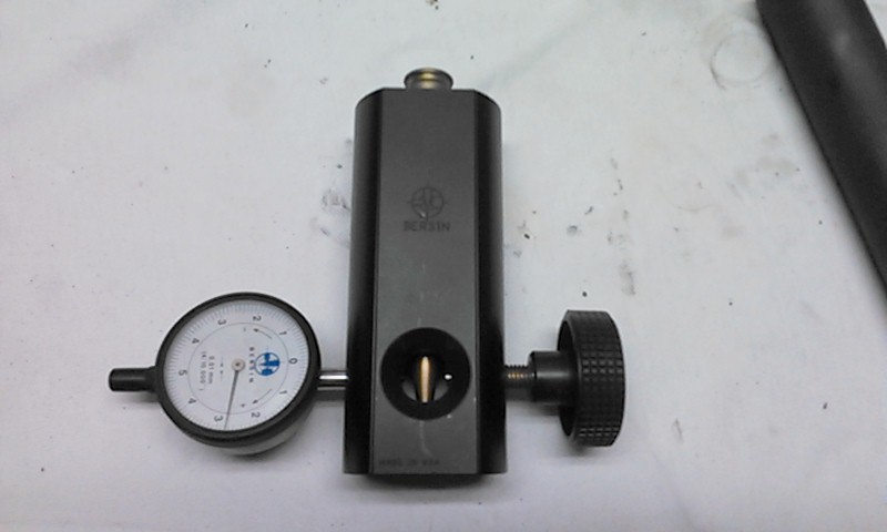

    I reload much larger brass then is being discussed here so my case preparations are extensive. Primer pocket gets reamed to .318. Flash hole debured(both ends). Trimmed for length. Neck turned to .020 (for consistent neck tension). Cases weighed and separated in lots as well as bullets. When it's all said and done, I run each round through a Bersin device.

    I reload much larger brass then is being discussed here so my case preparations are extensive. Primer pocket gets reamed to .318. Flash hole debured(both ends). Trimmed for length. Neck turned to .0020 (for consistent neck tension). Cases weighed and separated in lots as well as bullets. When it's all said and done, I run each round through a Bersin device.
    Do they sell those still?

    I think so, I've had mine for about 8 years.
