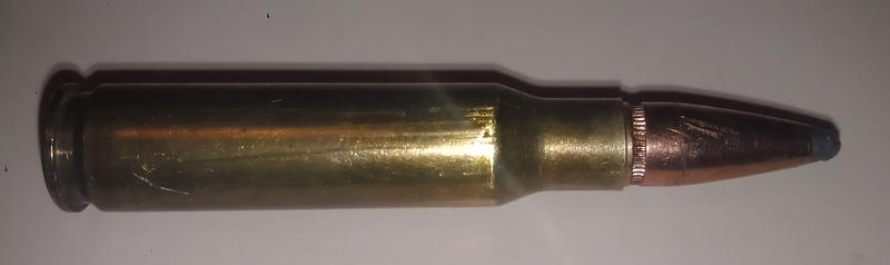

    Kind of OT but I found this reloaded 308 round under the table in lane 12 at talon a few weeks ago.
    Case was trimmed and de-burred bullet looks like a Corelocked Remington. Possibly pull marks on it. Case is FC.
    And little to no crimp.
    Anyone recognize this?

    Not I.
    But it sure looks like whoever loaded it needs to read up on the purpose of the canelature.
    . . . or maybe they trimmed the case too short and had to have the bullet stick out that far to make 2.800 . . . . who knows. Folks do some crazy stuff . . .
    Maybe they were of the mind that "more bullet in the rifling is better", like .040!

    I'm just going to pull it and recycle.

    Not I.
    The cannelure is worthless if you're not going to crimp... you should see some of my 6.5 CM loads using the 120gr SST... the cannelure sits WELL ABOVE the case mouth... no issues at all.
    By the way, WTF is a CANELATURE?... lol
