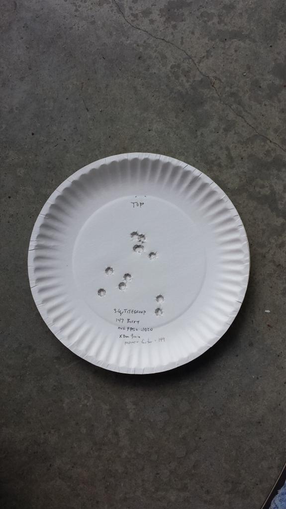

    For anyone that cares...
    Seems the max load gives me the best accuracy in my XDm 9mm. They are running about 1020 FPS, so plenty fast for making minimum power factor in USPSA, and still slow enough that I don't feel a real heavy recoil. This was chrono'ed at about 10 to 15 feet in the shade, and the paper plate is at 25 yards. (Whatever the distance at bay 2 at Talon). Anyway for what it's worth, this is what I get.
    Coach.
    3.2 grains - Avg. FPS - 915 - PF - 134
    3.3 grains - Avg. FPS - 963 - PF - 141 - S.D. 7
    3.4 grains - Avg. FPS - 965 - PF - 141 - S.D. 7
    3.5 grains - Avg. FPS - 980 - PF - 144 -
    3.6 grains - Avg. FPS - 1020 - PF - 149
    C.O.L. - ~1.225 on all of my test rounds.
    Measured using standard XDm 9mm

    Were you shooting controlled pairs, or each shot as an individual?
    Sophomore
    Mar 2014
    North Florida
    135
    Individual take your time, breath, squeeze, make sure you don't shoot your chorno shots. "Bay 2 is 15yrds....", must need my glasses next time!
