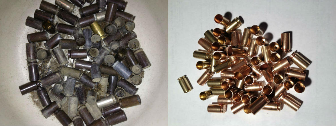

    I took the plunge and bought a stainless steel media cleaner. Time consuming but it cleans awesomely. It will polish the annealing marks off the neck of 5.56 brass. If brass isn't that dirty, I use a Dillon case cleaner with corn cob media with polish thrown into the mix. I use about two capfuls of their polish.
    I found the before and after pics on the effectiveness of stainless steel cleaning. It's fairly profound, and I don't think there is any other way to get these results otherwise.
    Edit: I took these photos myself from brass I picked up/dug out of the ground myself. I ran them through a Thumber's Tumbler for a few hours. I just didn't want anyone to think this was a stock photo!

    AB- I remember you had an issue with brass becoming brittle, but I can't remember if you determined it was the SS media or just old ass brass from the ground?
    Any issues with SS media and brass?

    No brittleness normally. That particular batch had been in the ground a long time and it compromised some of the brass. That experiment was a long time ago (posted originally on TGF), and I lost about 10% at the reloading bench when they split upon being resized. About 25% split on first firing, and I still have some of them kicking around. About 25% have lasted at least 8 or so loadings.
