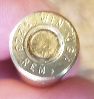

    Usually crimped pocket brass either has a ring around the primer or has 3 staking marks..

    Here's the head stamps in question. The primer that is seated is the first one that went.

    An rcbs military crimp remover on a simple press is how I deal with crimps.
    Crimped primers.
