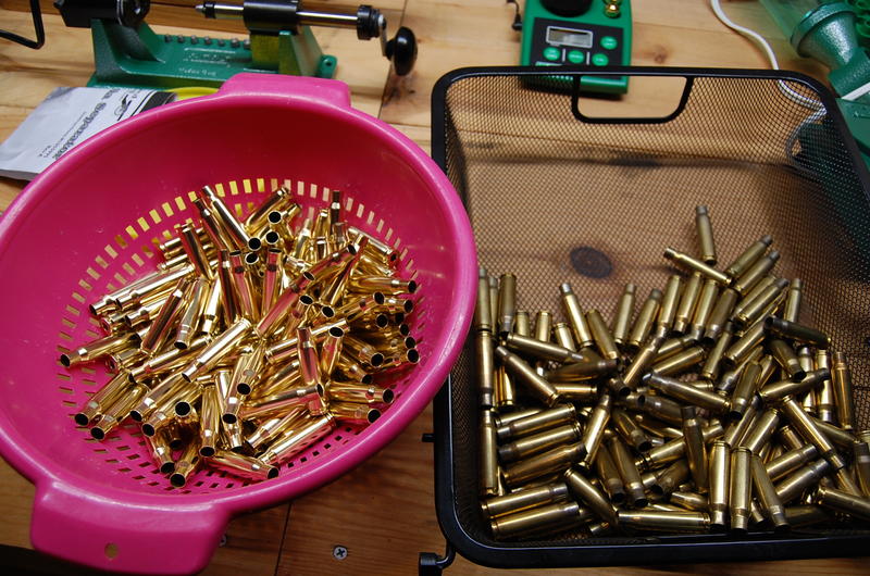

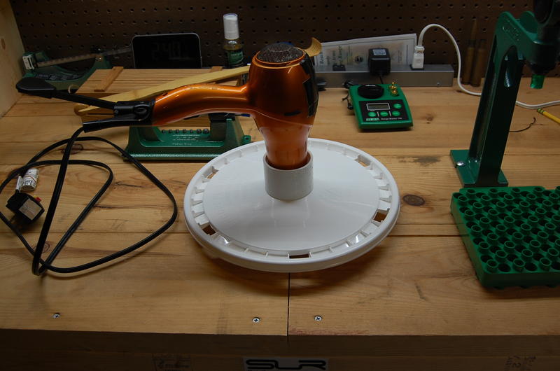

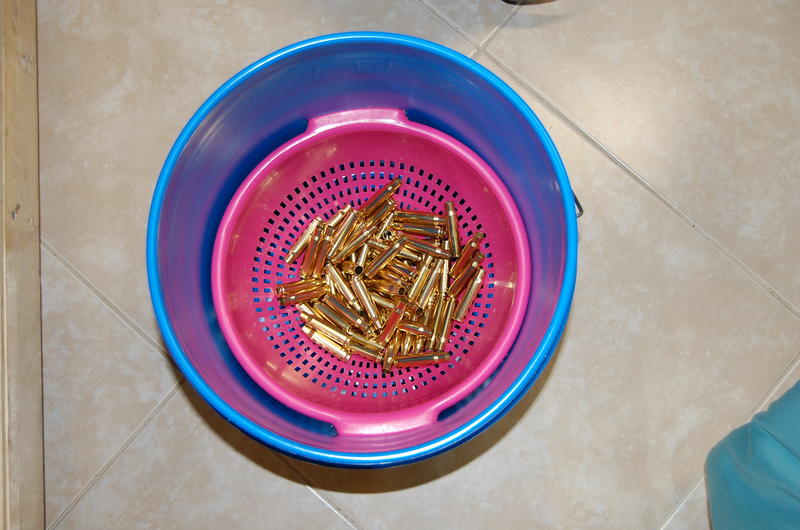

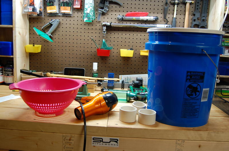

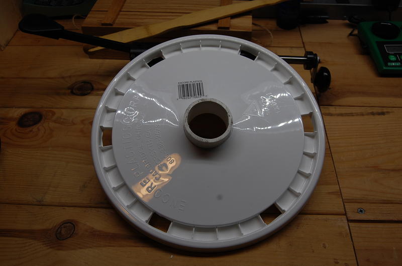

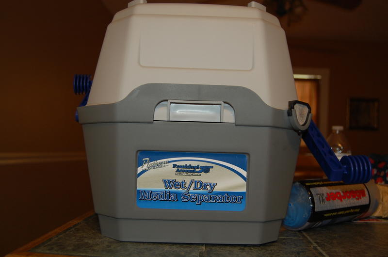

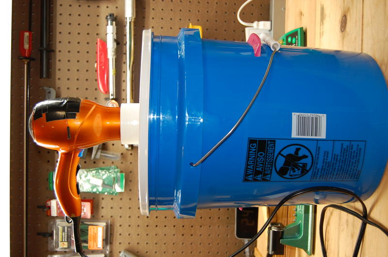

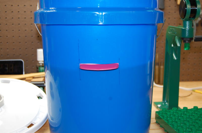

    Finally got the Wet Tumbler and wet/dry media separator. I love the result of the wet tumbler, with just 3 hours of tumbling(was told, that I only need a 90 min tumble, or 2 hours tumble, if brass is really dirty). Also love the idea, of the media lasting forever( if I don't loosed). Primer pockets are clean also. After reading about the drying complain, I will be working on a drying station, made out from a 5 gallon paint bucket and lid, spaghetti strainer and an old hair blower. I used a car drying chamois and the blower and the brass dried really quick. Tumbler (1).jpgTumbler (3).jpgTumbler (4).jpgTumbler (2).jpg

    I dry my brass in the oven usually. Set it on 170, put the brass on a pizza tray and let it relax.

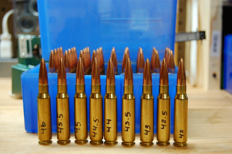

    My first reloads of 308 win. Now I need the range to open for 100 yards to test. Handgun (1).jpg
