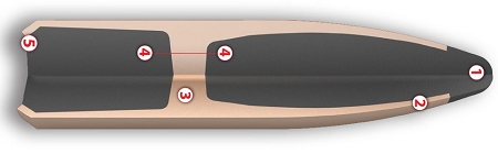

    30 years ago when I started there were only a few companies that made bullets for people who reloaded. Nosler, Speer, Hornady, etc, and you bought the manual for the specific bullet you would be loading. I think that still holds true, although there are bullets now that are almost, if not identical (Grains, shape, BC) made by MANY different companies. Such as the .224 55gr FMJ.
    When I was starting out, the Nosler Partition had just been developed. It was to revolutionize the hunting round, especially on game like mule deer, elk and such . Lots of bullets of the day would not hold together when bone was hit, many retained less than 50% of their original weight - penetration was a problem. The partition was designed to actually have a brass partition midways with lead loaded from both end. In theory and practice the Partition would only mushroom to the partition, retaining 75% of it's initial weight. I'm sure there's just as good or better bullets out there today, but I still reload Partitions for hunting. Want to shoot hogs in the head or neck with your AR15, try the 60gr Partition.

    That look interesting. I can't wait to start reloading. There's so much to learn. Thanks for the advice.
