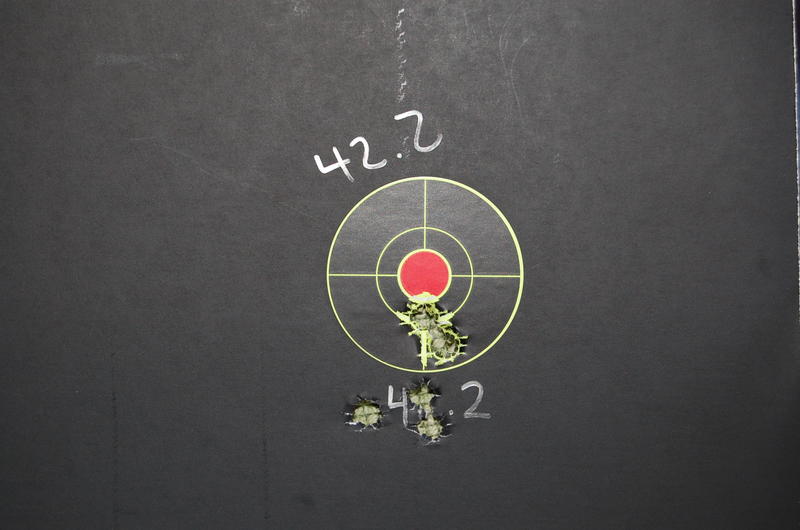

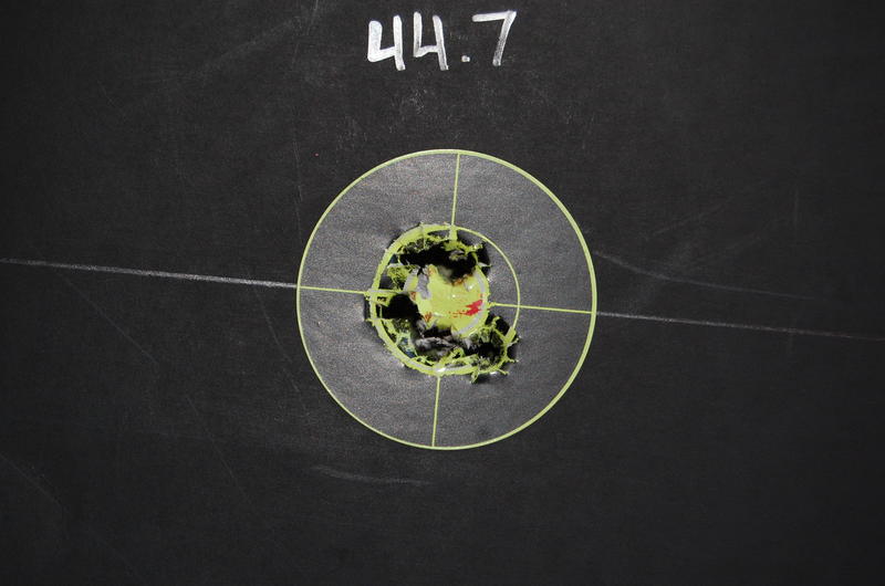

The range was open this weekend, so I test some other loads around the first loads I liked 45g and 42.5 g of varget, I did 9 more loads of 5 bullets each. There's one load, that I'm baffle with, the 44.3 load, have 3 shoots going in one hole...... or so I think. The target only show 3 holes but one hole is bigger than the other 2, telling me, that there's the possibility that more than one bullet pass trough that hole. No...I didn't shoot someone else target. The closes target to mine , was around 20 feet away, and my target was the only black target out there, so I can see the bulls-eyes better. I check the other targets on my board and none have more than 5 holes in it. I did notice, that the loads around my initial 2 numbers are good. I was able to hit good groups and since this was my second rodeo, I was not afraid of the rifle blowing up. DSC_0466.jpg DSC_0467.jpg DSC_0468.jpg DSC_0469.jpg DSC_0470.jpg DSC_0471.jpg DSC_0472.jpg DSC_0473.jpg DSC_0474.jpg

I do like the 42.4, 42.5 and 42.7 , I will stick to those grains of powder for my 100-300 y shooting. The 45 gr, will be for 600+ yards, when I can go to a range that have that distance. When I get the chance, I will definitely try them at 300 y. Now I can concentrate on the 6.5 creed.
