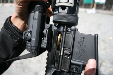

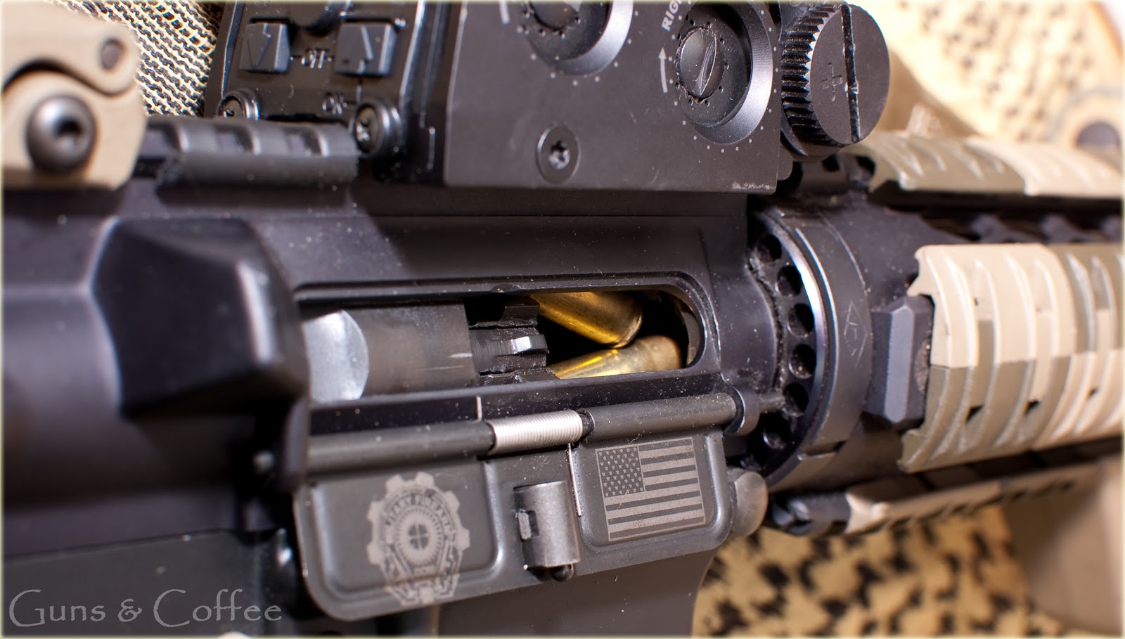

    bolt over ride=the bolt jams a live round up into the upper near the gas tube
    b.o.b. = spent brass fails to eject, gets stuck above the bolt in the upper receiver.

    Bolt Override vs Brass over bolt. Explain difference please?
    As many know, brass over bolt is where a round gets stuck on top the bolt, pressed against the top of the upper and CH.
    I would imagine bolt over brass is one of those malfunctions where the bolt starts to strip the round from the mag but loses positive control of the round causing the bolt to jump over the back of the case thus wedging the round against the feed ramps at or about mid case... common in over gassed rifles.

    Quote Originally Posted by e.money83 View Post
    Thanks... pics, 1000 words, and all that...
