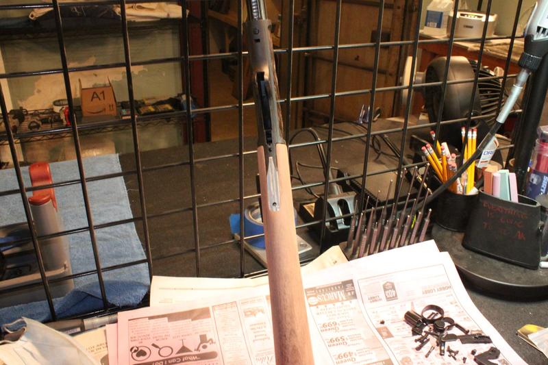

How much to remove poly from Garand stock AND preserve the dod and p marks?

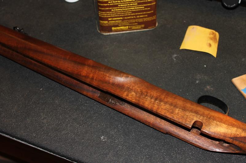

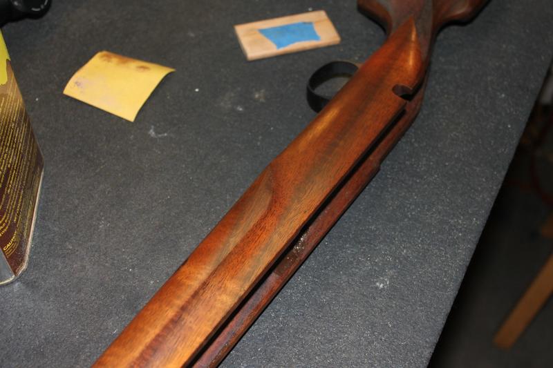

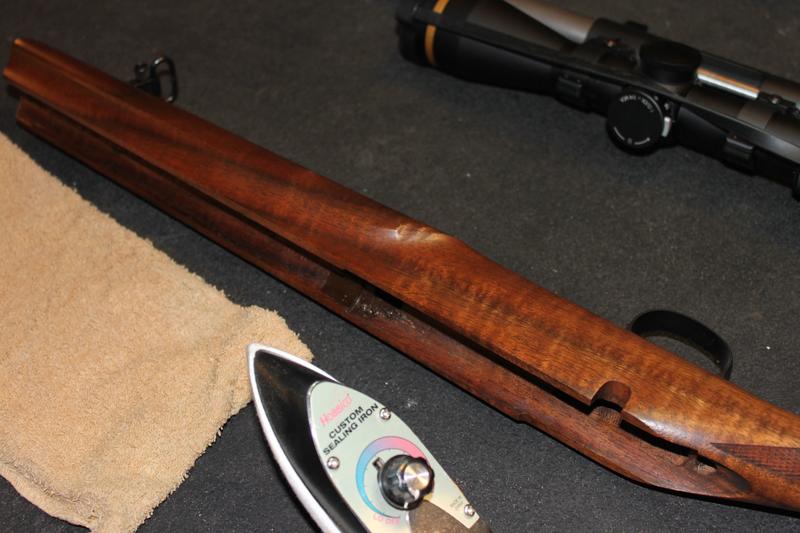

To remove poly and fix any dings, etc and go back with an oil finish will run about $300. If you'll notice, most war guns have deep and open grains. This allows a lot of moisture to get into the wood and cause potential damage. When we run the finish all the pores get filled, so it looks smooth and uninterrupted across the wood.

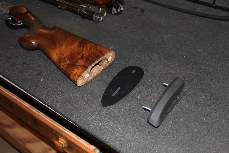

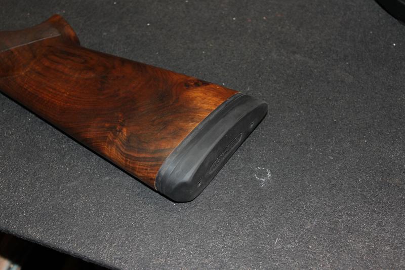

Attachment 12725 Attachment 12726 Attachment 12727 Attachment 12728 Attachment 12729 Attachment 12730

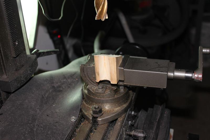

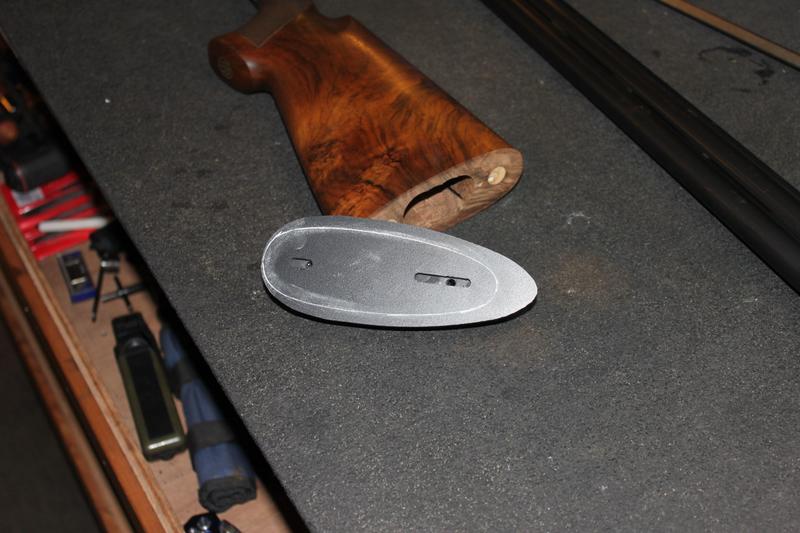

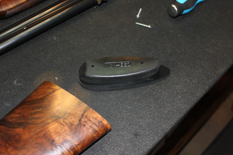

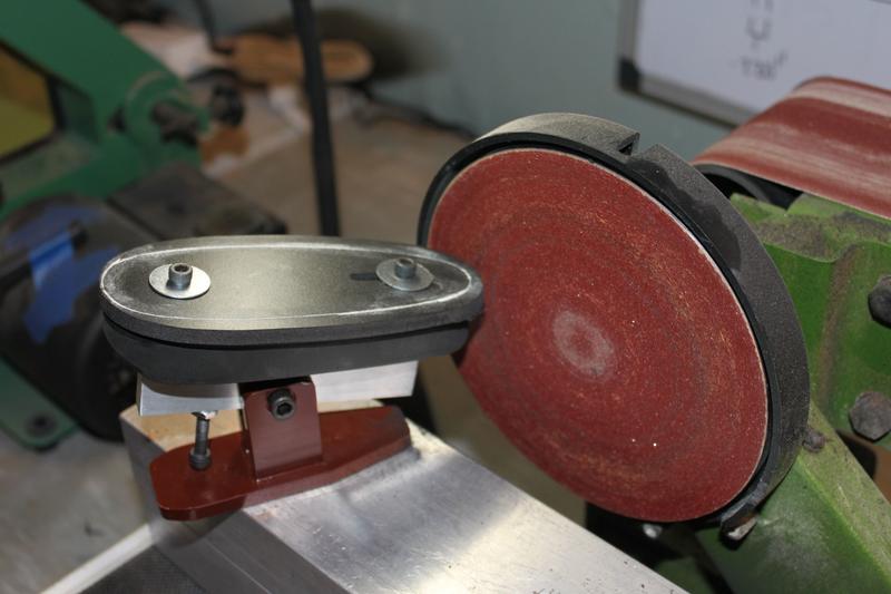

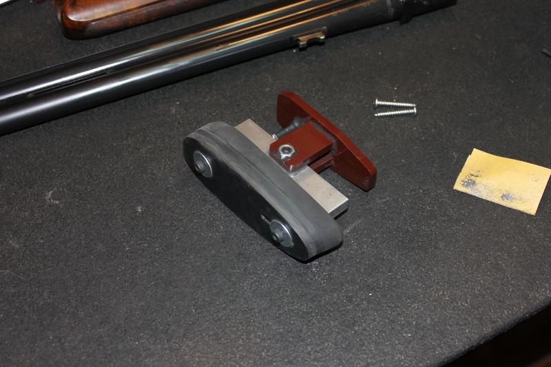

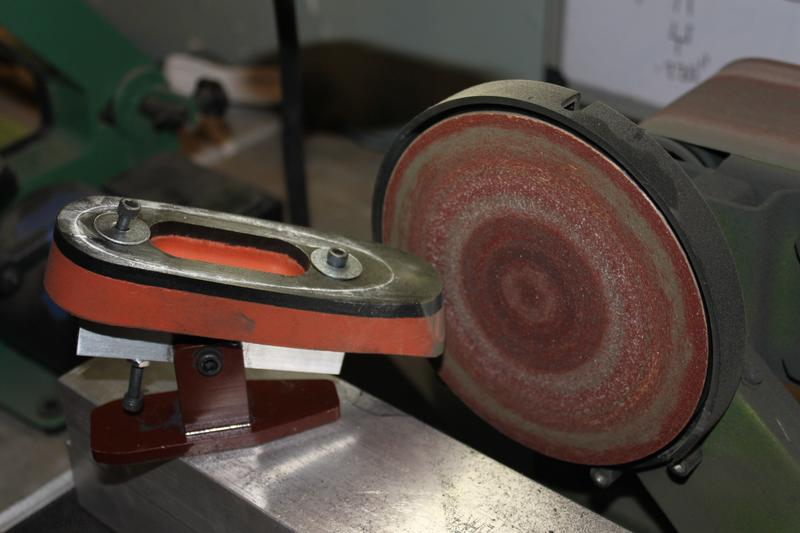

Fit for spacer and pad for Beretta 687DL
Attachment 12731 Attachment 12732 Attachment 12733

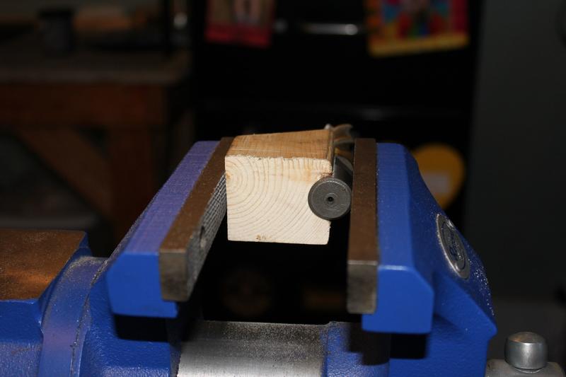

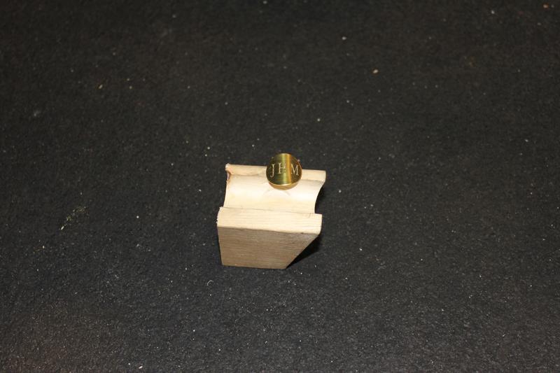

Building a jig to bend an engraved brass plate for SxS stock
Attachment 12738

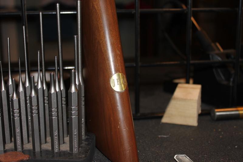

Engraved and inlaid brass escutcheon for Ithaca SxS

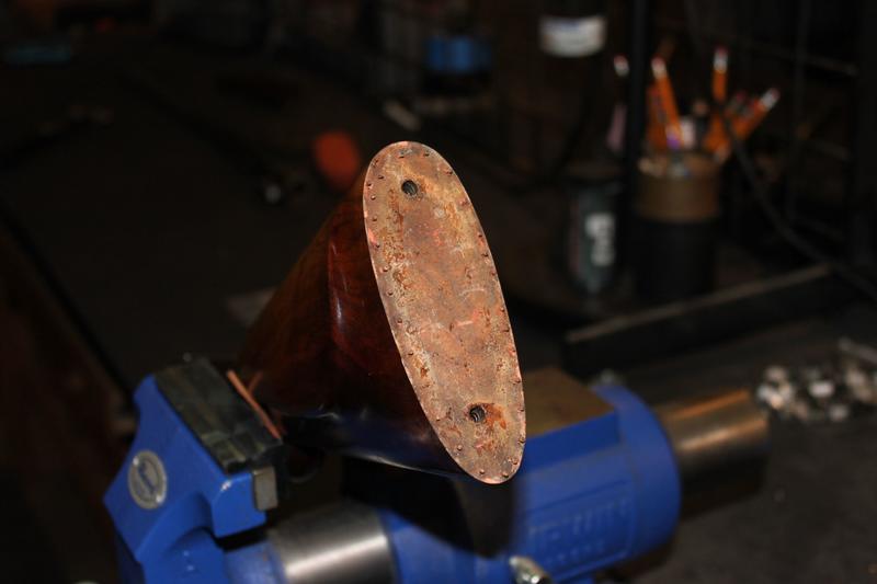

Attachment 12760 Attachment 12761 Attachment 12762

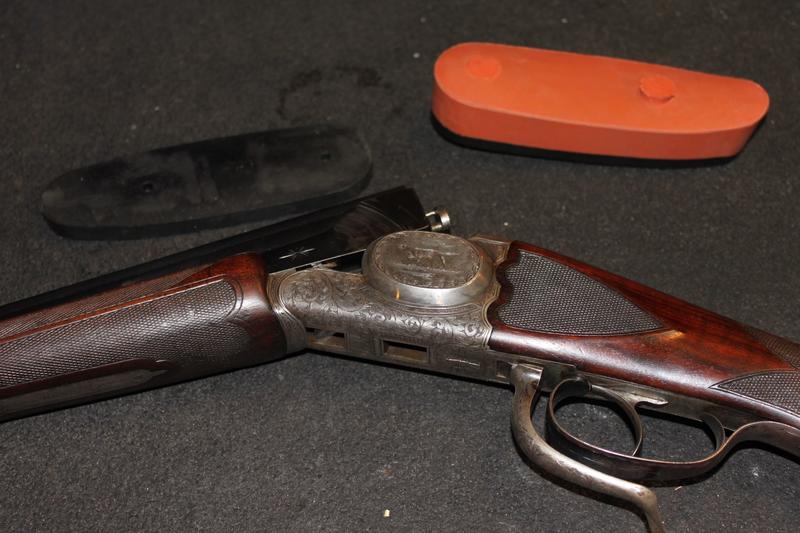

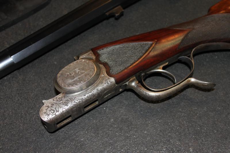

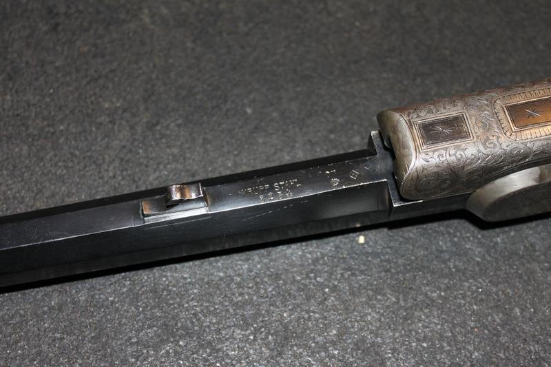

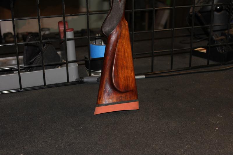

Began installing a period correct recoil pad on a Burkard and Behr trap shot gun. The German 12 gauge is a break-action design circa early 1900's with a bottom lever that sets the hammer and breaks the barrels. The barrels are marked as Krupp steel and the engraving and final finish were performed by the American company L.C. Siner. An extremely rare piece.

Finished product for the Behr/Siner

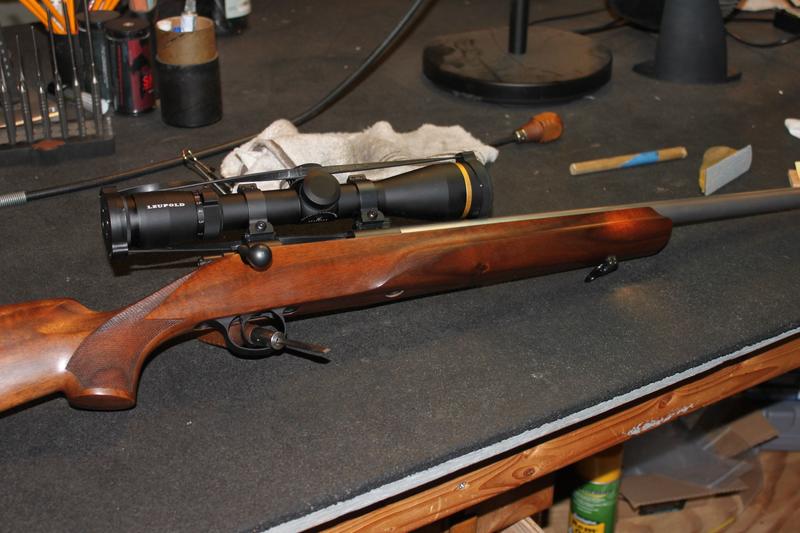

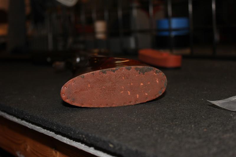

That looks like first class work, what's a ball park figure for replaceing the recoil pad on a sako bolt action rifle ? The original one is starting to crumble from age . ( early 70s vintage )
Flt,my son replaced the one on my Sako 223.Perfect but he said he did not want to do another.He had to go on the internet and find someone would had an original pad.Found one at some gunsmith up north.Dang pad cost almost as much as Jafar quoted you to install it.
NOS Sako pad on flebay for $124 now, I believe.
Thanks guys , but I have several new old stock sako recoil pads I've had them for years. I'm sure some one on you the Internet will say otherwise but if you store a long gun barrel down the pad will last a lot longer.
J , those old pads had to be fitted , all the stocks weren't the same back then . The wood blank that some of those old sako stocks were made from would cost several hundred today , if you could even find wood that pretty.
This very true Jafar,this pad was not fitted for this rifle and had to be ground to fit.As a one time owner of various Sako's from the late 60's and mid 70's all of them were different sizes on the butts.Better plan on fitting even if it is a Sako pad.Still have a couple.
Nice work Jafar! My 223 Sako has 30 coates of hand rubbed oil finish,took over 6 months to do right.

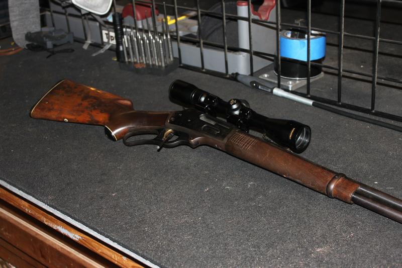

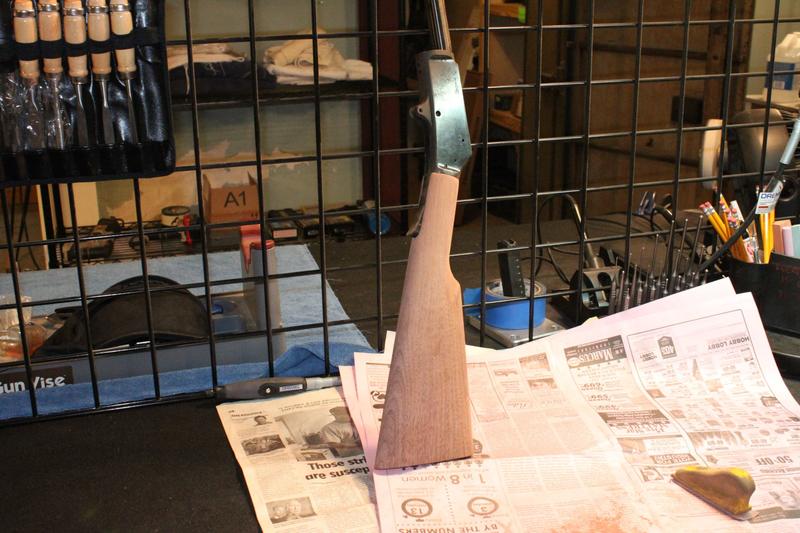

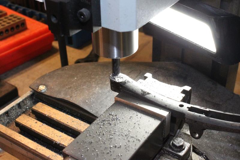

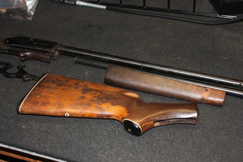

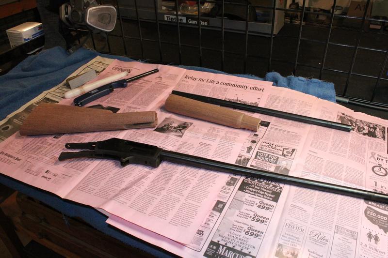

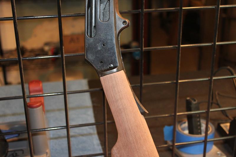

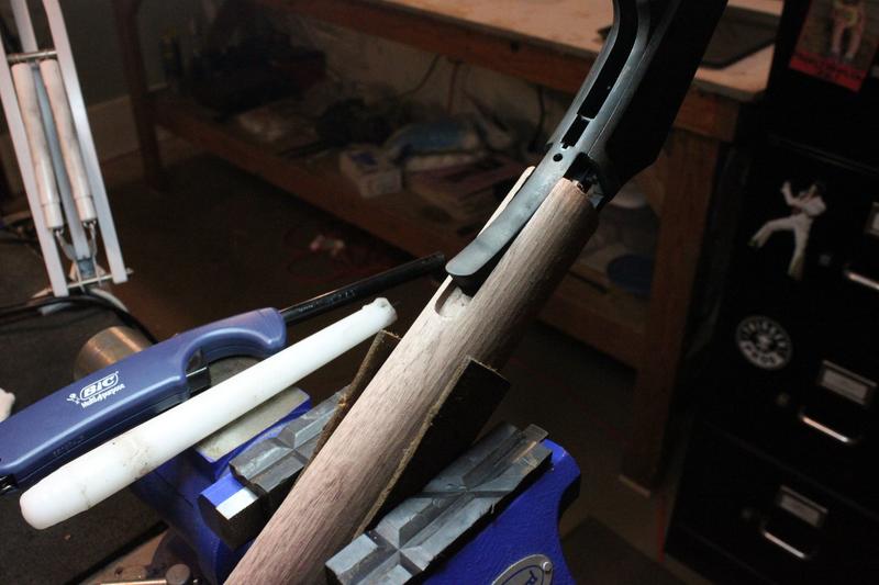

Restoring a Marlin 336 and going with straight grip Texas style. Much work left to do.

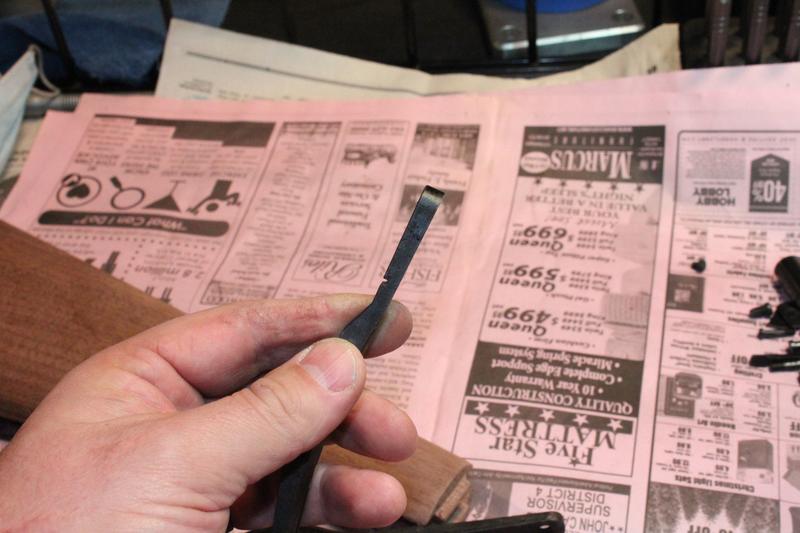

Attachment 13191 Attachment 13192 Attachment 13193 Attachment 13194 Attachment 13195 Attachment 13196 Attachment 13197 Attachment 13198 Attachment 13199 Attachment 13200 Attachment 13201 Attachment 13202 Attachment 13203
My .35 inspired you, didn't it....you can admit it.

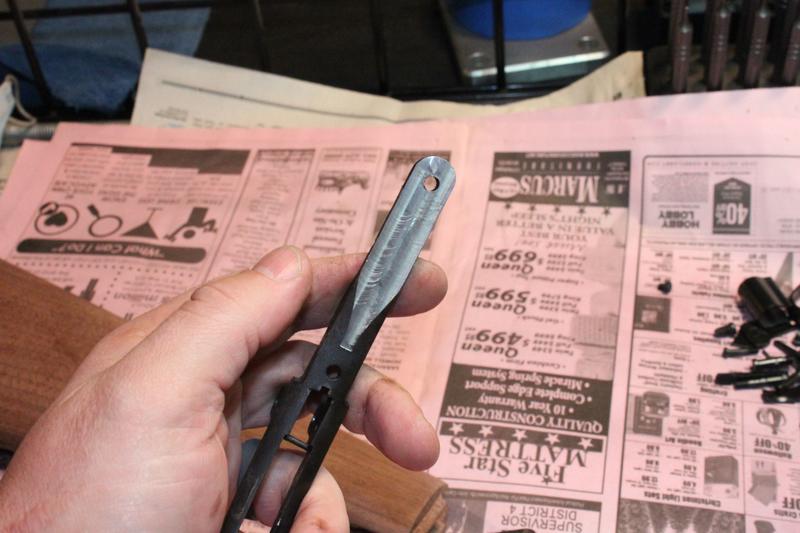

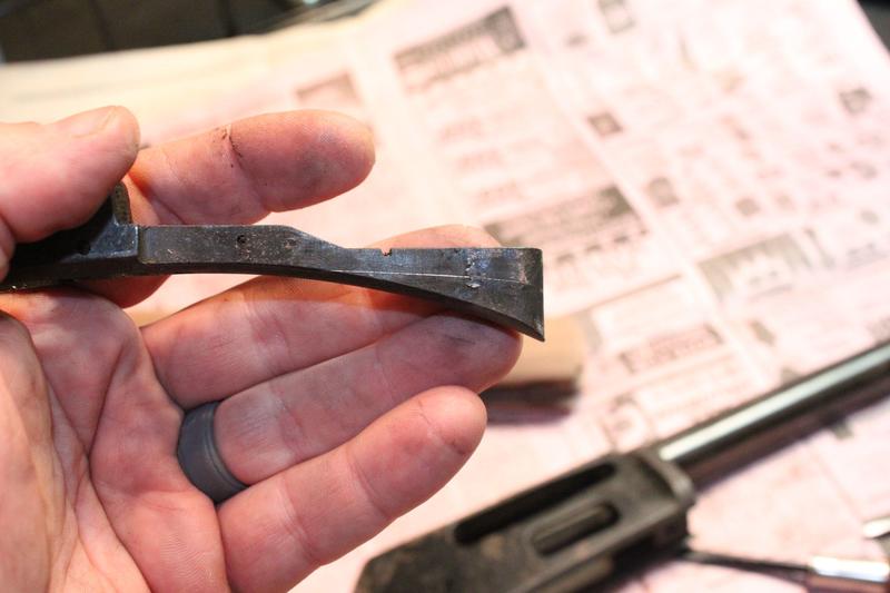

Man that looks really nice, what's the plan for the lever?
There's aftermarket levers. http://www.mulemangunworks.com/mule-...custom-levers/
Jafar does fine work,if you don't believe it take something up for him to do.
I'm actually gonna try my hand at using the existing lever to make a straight lever or some custom bell shape like the ones C/H showed in the link. Torch it up, take a hammer and mandrel to reshape, then treat/temper and kote it. Be the first time I've attempted such a thing, but the night shift coupled with copious amounts of Monsters and AC/DC are steering me in that direction.
Gonna need a bigger torch or a forge.

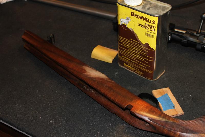

Final prep and first coat
Jafar, get you a test block of sanded wood and put a couple coats of tractor hydraulic fluid on it and see what you think. The wood takes the hyd fluid really good and it has a slight red tint.
Yeah, try it for real. I never seen it on a stock but for kiln dried YP it makes for nice looking siding. It's so fluid the wood soaks it up.

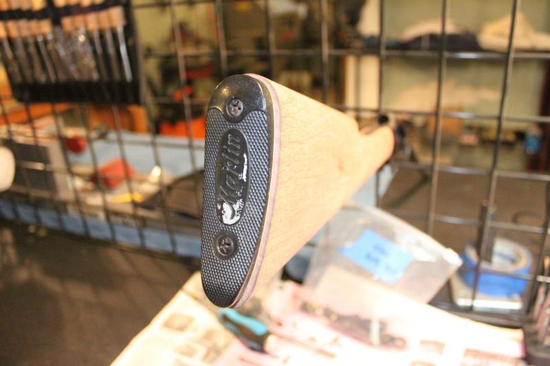

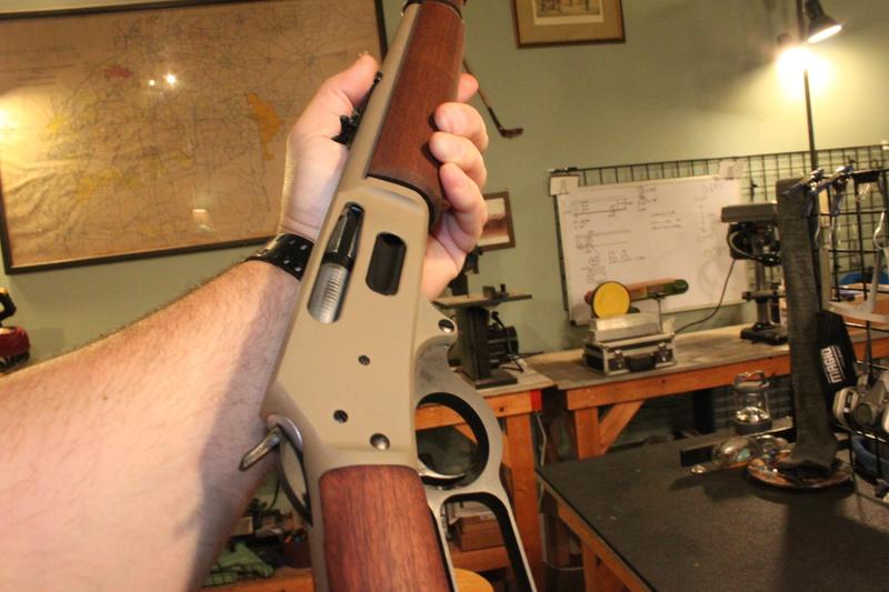

Attachment 13320 Attachment 13321 Attachment 13322 Attachment 13323
Gonna wax the wood and take some outdoor pictures tomorrow, but this one is going home.
That there is taking chicken shit and making chicken cordon bleu out of it. That looks really nice.
How do you like the ergonomics of the buttstock? Does it handle carried one handed?..
