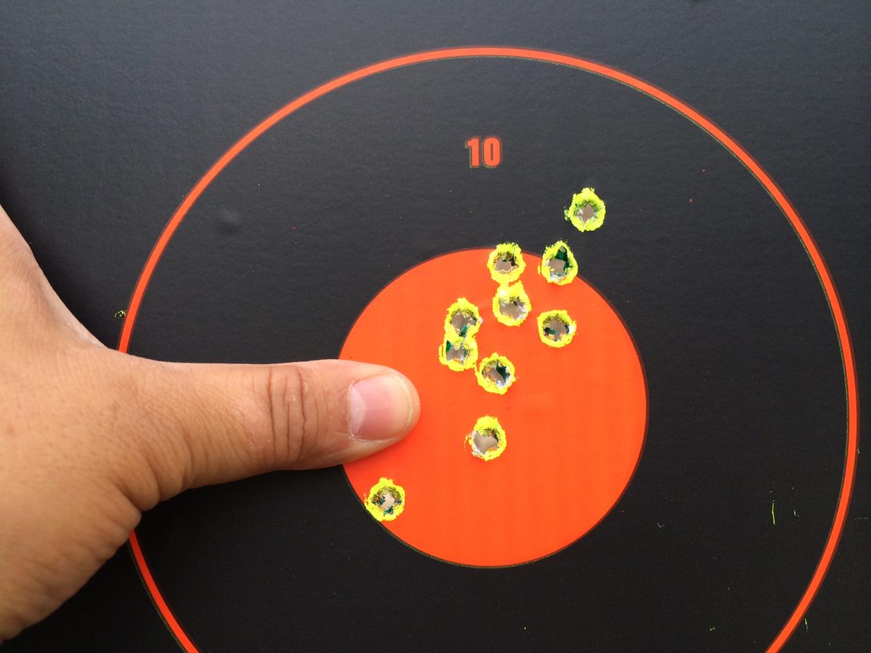

1st Batch
My brass as is, my bullets (I forgot what they are)
44.0 IMR 4064
OAL Not Uniform Due to Meplat
* Near max of 45.6 which is a comp load
Attachment 2202

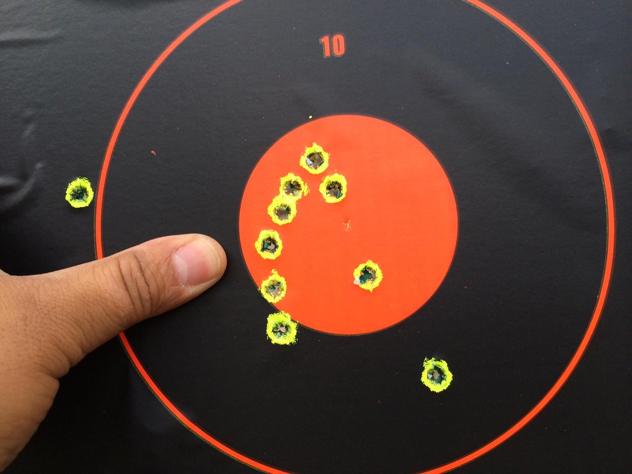

2nd Batch
42.7 IMR 4064
CCI Primer
Coal Not Uniform Due To Meplat
Coal @ 2.820"
Attachment 2203

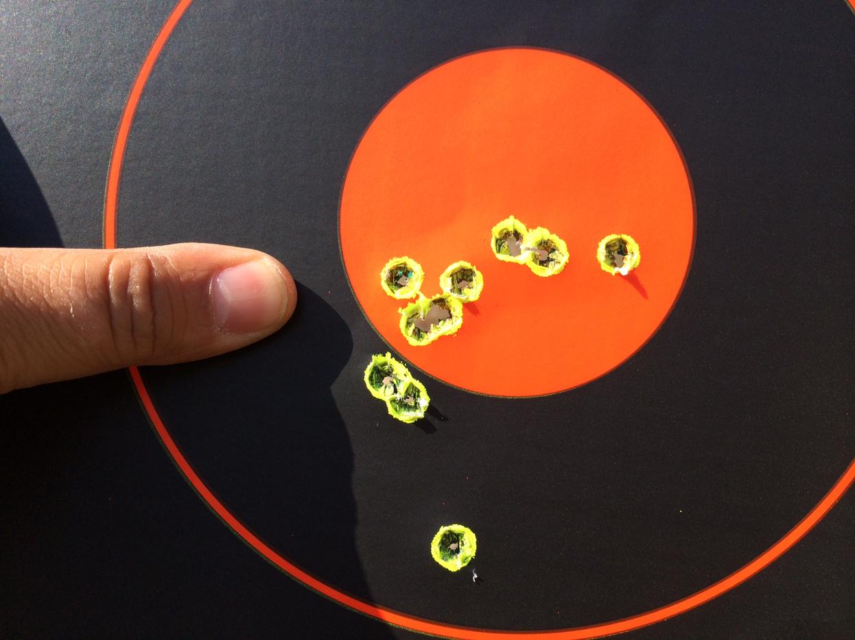

3rd Batch
My brass as is, my 175 SMK
41.7 IMR 4064
CCI Primer
Coal Varies @ 2.820" Due to Meplat Non-Uniform
Attachment 2204
* I myself feel that the first batch was the best, then 3rd batch, then 2nd batch. That's based on my own recognition of each shot I fired.
