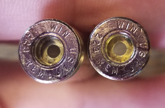

What brass is it? Can post pictures? Is there a way the pockets are crimped? I'm not an expert on reloading, so I would take pictures and send them to who is, which is mapper.....

Usually crimped pocket brass either has a ring around the primer or has 3 staking marks..

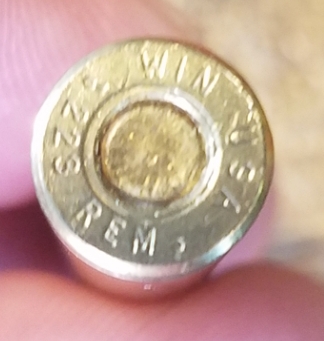

2 Attachment(s)
Attachment 17428Attachment 17429
Here's the head stamps in question. The primer that is seated is the first one that went.
