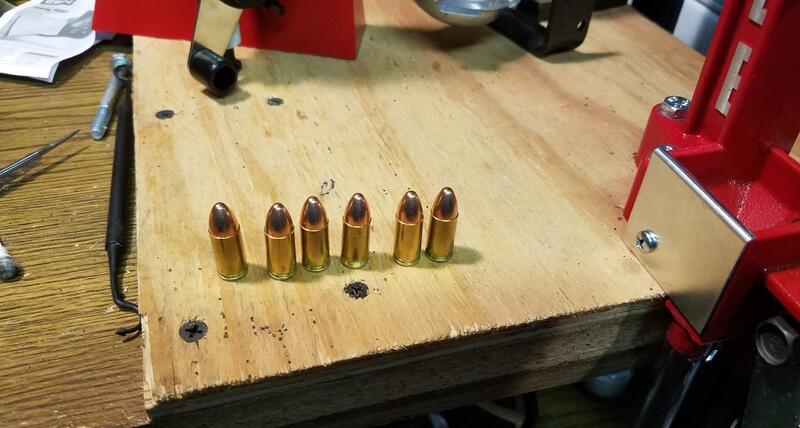

My shipment from Midway arrived late today. So I've been spending some time in the shop and this is what I've come up with. 124 gr. Speer over 5.1 grains of Winchester autocomp seated to 1.135" I'm going to give them a shot next time I get a chance to go to the range. Let's hope this works out. Attachment 16689
Primers seated a bit below flush? Any crimp? Looks good!
Put all the bullets in a loading block or normal factory ammo box. Put them in bullet down and look real close at the primers and the heights of the cases. Flip them over and do the same thing looking at the bullets. Anything not right will usually pop right out at you.
I also load everything one step at a time (when I reloaded last.)
Prime, put all cases primer up, check.
Put all cases primer down, put in powder. Any double or over charge shows up in pistol rifle is deeper so harder to see. I use powder that a double charge will overfill the case to make it evident.
Then add bullets. any not seated will also show up in a bullet block.
Weigh a good known loaded case. Then compare the rest to it.
I'm just looking at a photo, so what do I know? NOTHING!!!
But, I will say that I question the "crimp" or just plain old "neck tension". If the bullets are in there too loose and the bullet moves while being bumped around in the gun before firing, bad things can result.
Once again though, I'm just looking at a photo. I KNOW nothing.
