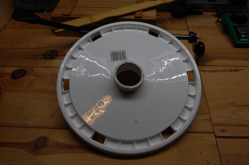

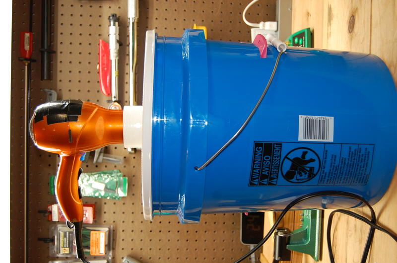

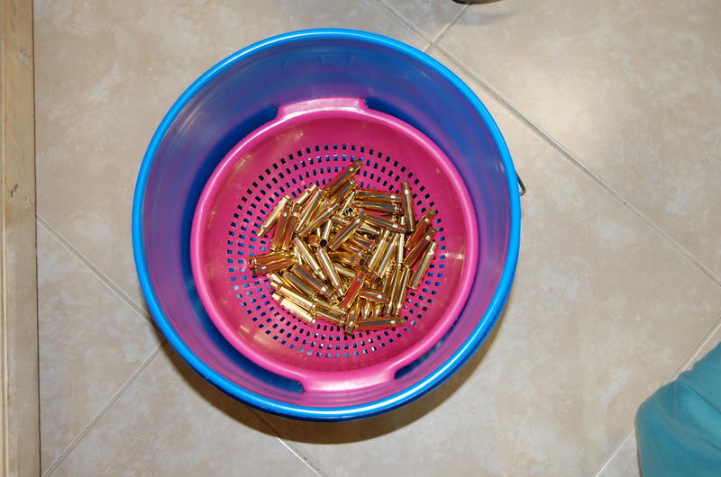

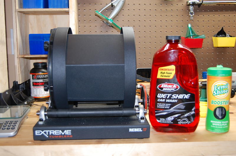

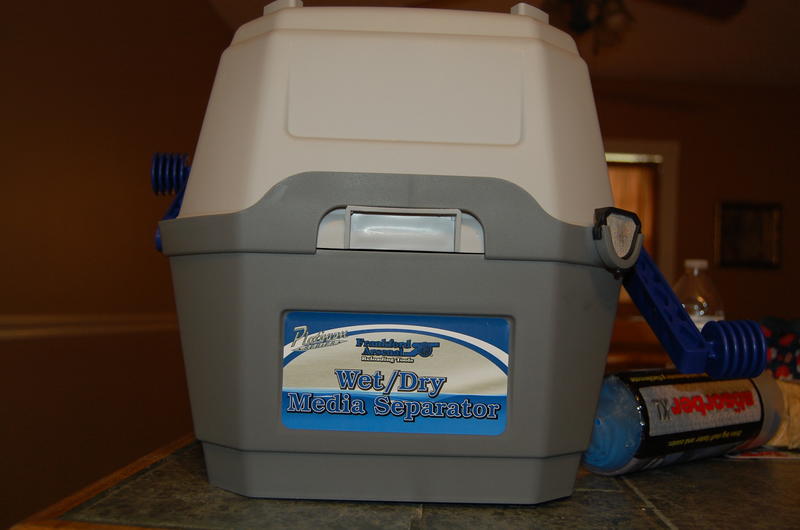

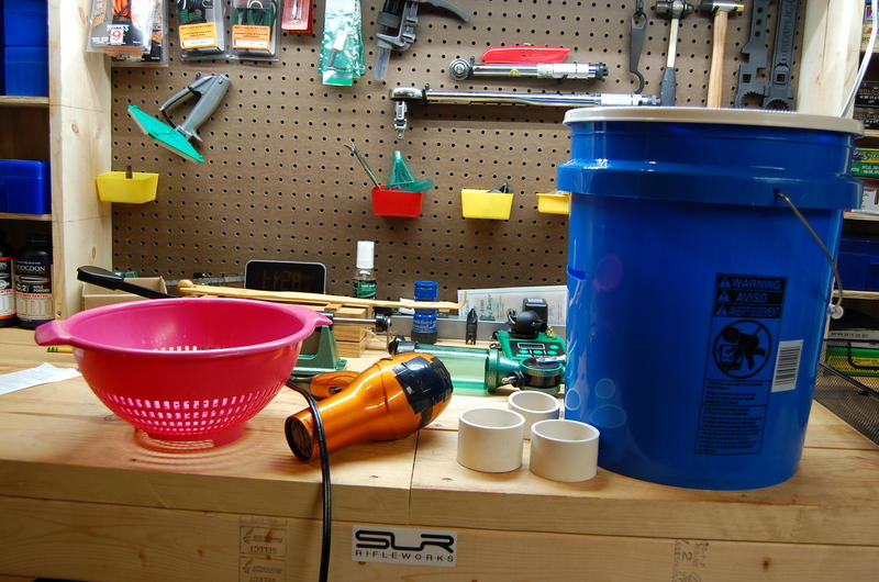

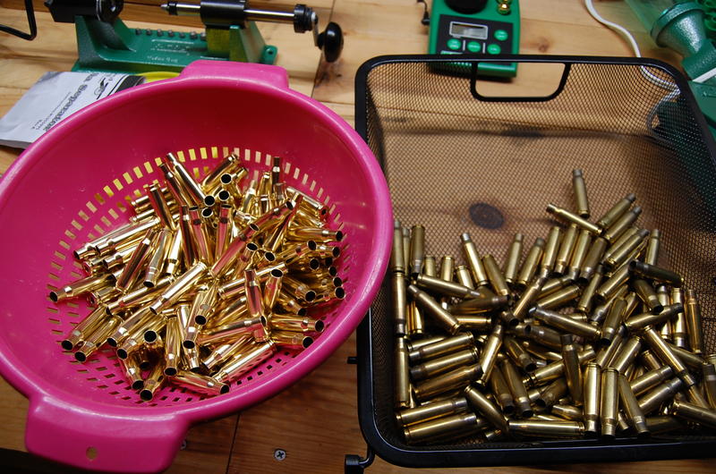

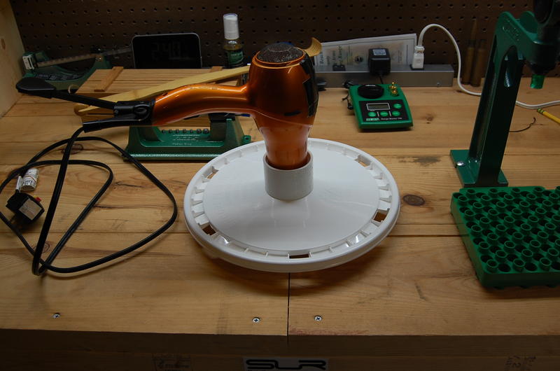

Finally got the Wet Tumbler and wet/dry media separator. I love the result of the wet tumbler, with just 3 hours of tumbling(was told, that I only need a 90 min tumble, or 2 hours tumble, if brass is really dirty). Also love the idea, of the media lasting forever( if I don't loosed). Primer pockets are clean also. After reading about the drying complain, I will be working on a drying station, made out from a 5 gallon paint bucket and lid, spaghetti strainer and an old hair blower. I used a car drying chamois and the blower and the brass dried really quick. Attachment 10333Attachment 10334Attachment 10335Attachment 10336
Cheap drying station for wet tumbling brass Attachment 10363Attachment 10364Attachment 10365Attachment 10366Attachment 10367Attachment 10368
I dry my brass in the oven usually. Set it on 170, put the brass on a pizza tray and let it relax.

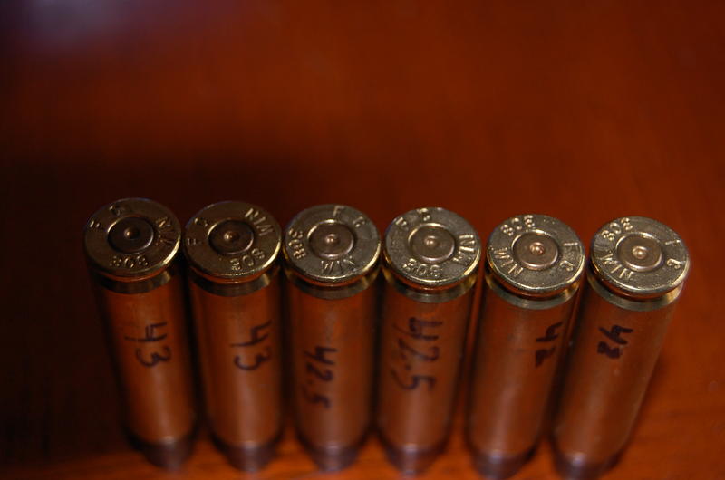

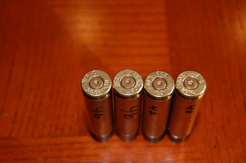

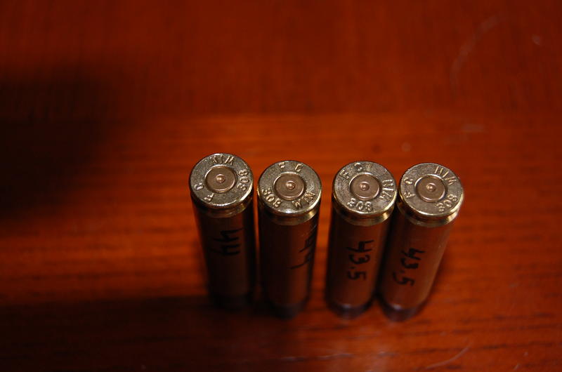

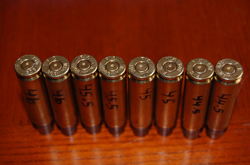

My first reloads of 308 win. Now I need the range to open for 100 yards to test. Attachment 10676

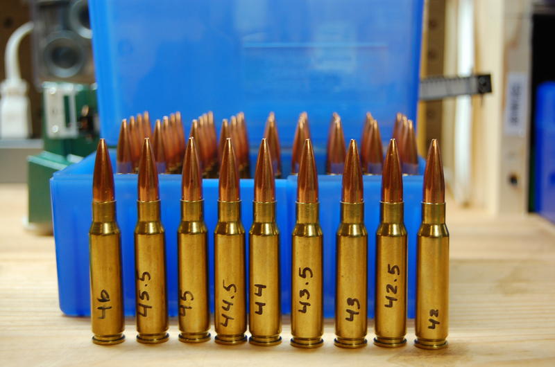

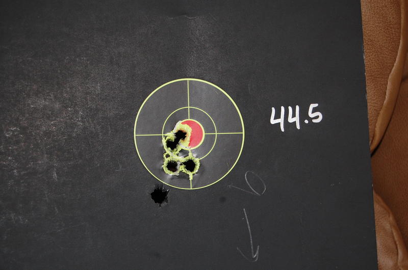

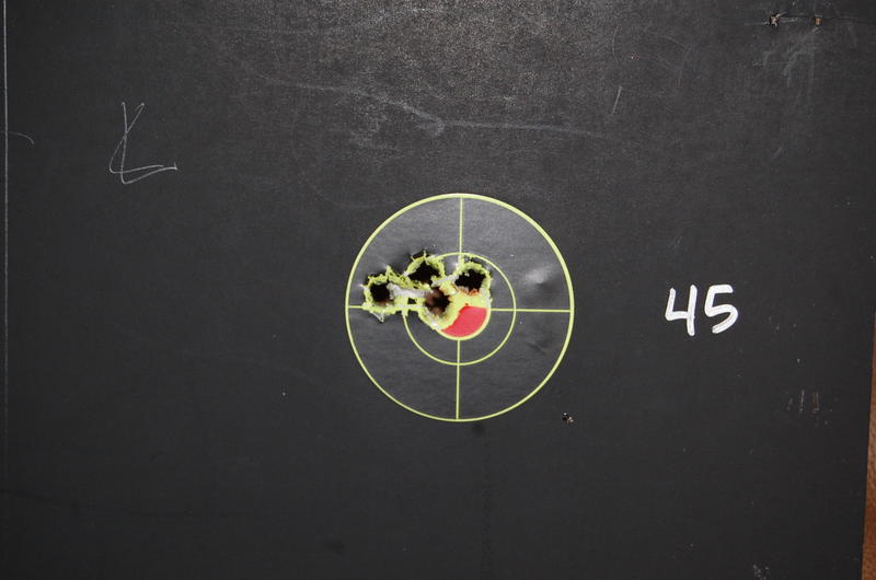

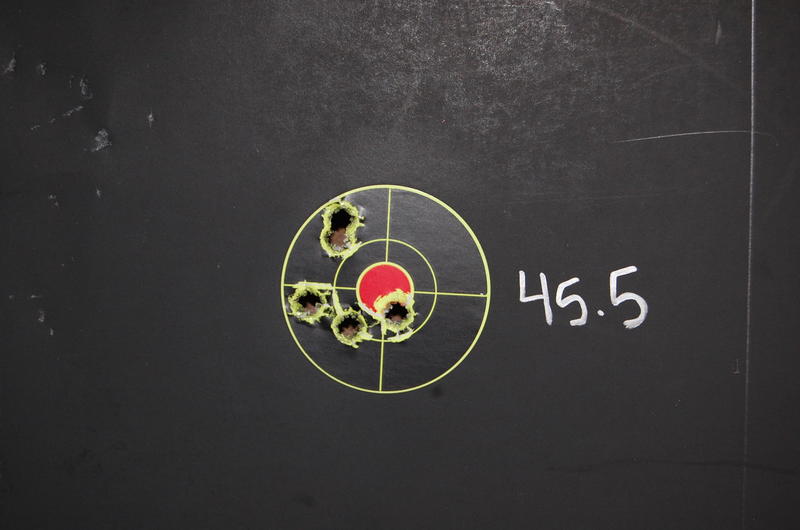

Just to let everyone know, I have 2 manuals. I have the Nosler reloading guide, that came with my kit. Many here suggested to get more than one, and compare the loads on the manuals, before reloading, so I bought the Lyman 50th edition. Another thing that help me A LOT, was private messaging Mapper, and I really appreciate all the help and knowledge he had giving me. I also did my first reloading VERY slow, step by step, double checking everything and I know, I could had done better, but it was my first time. Today, I was able to go test, what I reloaded. Let start by saying, I'm no season shooter. I'm learning the craft of shooting at the same time, I learn to reload. So flyers are abundant. That's is why, instead of 3 rounds per weight, I loaded 5 rounds for every weight. The bullet: Hornady Match 168gr BTHP, Primer: Winchester WLR primers, case: Federal once shot cases, NOT fired form and Varget powder. 100 yards, 2 inch targets. This were the results today. Attachment 10788 There is one missing round on the factory load of Federal premium 168 grain GMM . I forgot to dial the scope down from 300y to 100y, and the round was nowhere to be found. Attachment 10789 I started with 42 g, since it was the lowest load on both manuals for Varget with 168 bullet. I increased to load by .5 every time. Attachment 10790 two flyers here. Attachment 10791 I don't think the 2 outside of the target were flyers because the groups started shrinking. Attachment 10792 I think 43.5g, is bad shooting from my part. 44g Attachment 10793 , 44.5 Attachment 10794 group getting better. 45g Attachment 10795 I like the 45g group. 45.5 Attachment 10796 group, started oppening again. 46g Attachment 10797 still a good group, but I didn't want to go any higher. I know the groups would be better, if I was a better shooter. I liked the grains between 44.5g to 45.5g . I think the 45g group was the best since all 5 rounds were close. The 42g and 42.5 groups, with out the flyers are great also. What do you guys think?

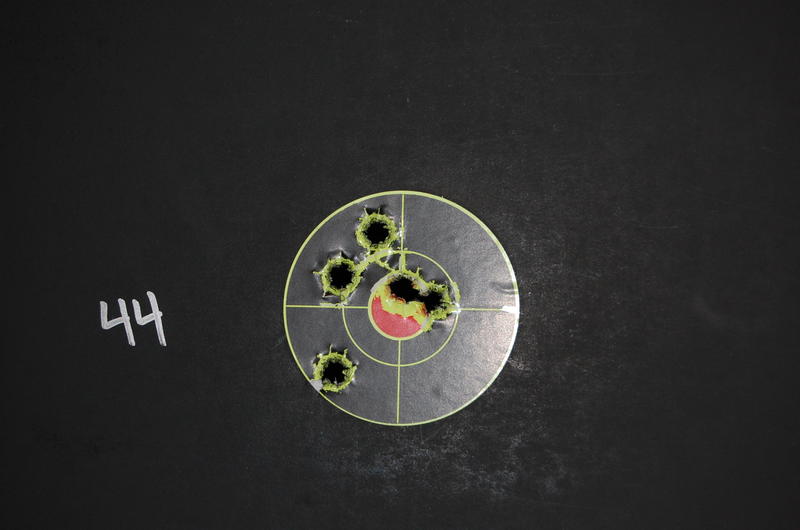

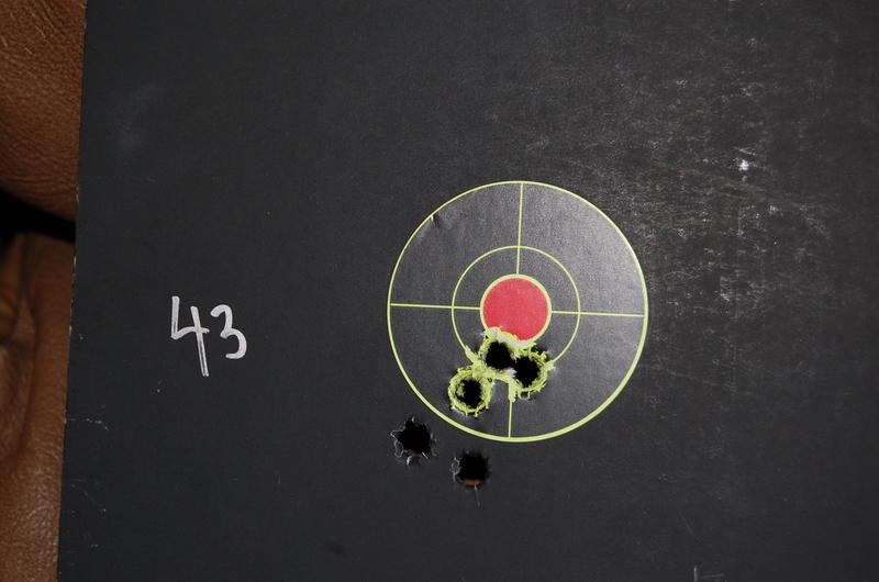

I think you have it figured out.

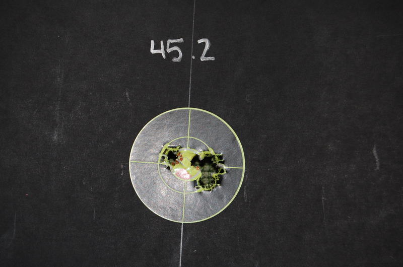

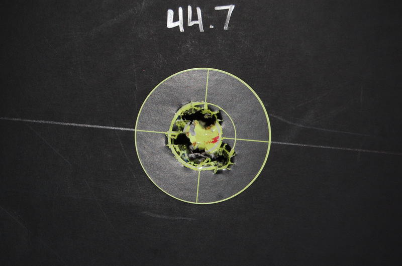

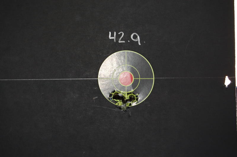

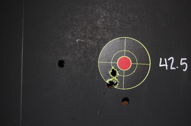

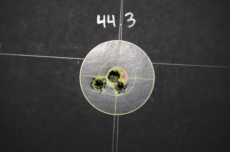

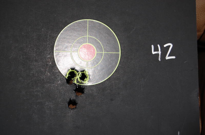

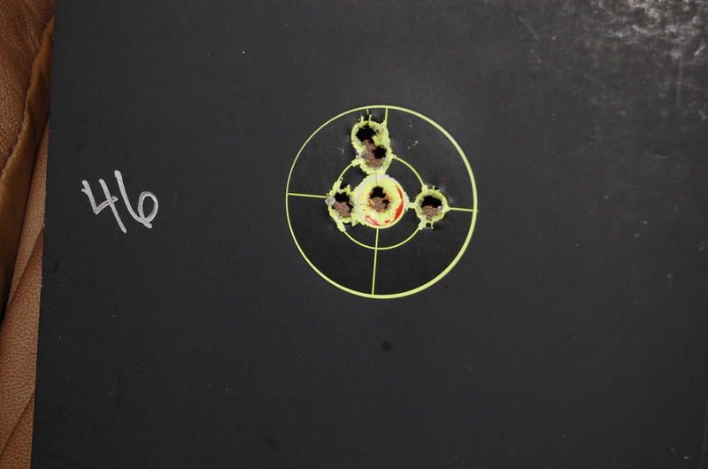

The 45 looks best to me. However measure them to be sure.
While vertical dispersion looks good at 45 gr, how did the primers look?
were they flat, or still had a little radius left?
Did they show any signs of cratering where the firing pin struck?
If no ejection issues, or signs of pressure, you could either run with it,
Or you could try and dropping the charge weight about 0.2 gr from 45 gr, as well as increasing it to 45.2 gr.
It may get a little better, or not.
The idea here is to have a little leeway in charge weight from your desired charge.
For temperature and powder lot variations.
Then you may or may not decide to experiment with seating depths and see if that makes a diffrence.
The seating depths if you are using them in a magazine will be the limiting point if you don't want to single feed.
At some point you will get to the "that's good enough for me" point.
You may be there already, but the process is sound that you have gone through.
The rifle will tell you what it likes.
A load that looks good at 100 may be diffrent at 300,
But it is a good place to start.
Thanks for posting your results. :goodjob:
Looks good.
It is a bit of work, but satisfying when you find a load the rifle really likes.

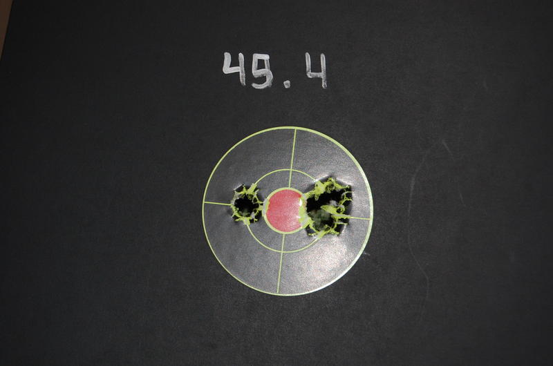

Mapper, to tell you the truth, I saw no difference between the 42.5g primers and the 46g primers or brass. Once I pass the 43.5g, since I was scare shitless, I was inspecting every case. I think been scared, was the reason, I had so many flyers at the low grain bullets. After the first few, I was more confident. I had no ejection issues either. Maybe was because on this testing rounds, I ran the brass on a sami specs, full length die. I have not touch my fire formed brass yet.
I was thinking, I might do another test, but this time, do .1g increments starting at 44.6g, since I already have a 44.5g results, all the way to 45.4g. My problem is, that I don't have a range that is open everyday with 100y close to home. I love going to the police range, The Policeman running the range, are always funny and fun to talk too. I do have a public range closer, but my experience there, was not a good one. Talking to others, their experiences been the same as mine. I might have to bite the bullet and go there.
On the size of the bullets, I measure my lands at 2.89. The inside of my Accurate mag, measured at 2.98, so I think I'm good there. I will double check, once I start using my fired form cases. I plant to remeasure everything again. I also notice that at the low grains, the group were close, but impacted lower, than I was aiming. the 44.5g to the 45g, were impacting at the aiming level. 46g did the same and higher. So I will stay around the 45g +- loads. Thanks again for all the help and opinions you guys gave me.
Attachment 10811Attachment 10812Attachment 10813Attachment 10814
Primers look good on 46 gr,
I don't think that 0.1 gr powder steps will tell you anything measurable, other than using components.
That's why I suggested a step halfway between what you had.
The node should be bigger than 0.2 gr.
Remember 0.2/46 = 0.4% of case capacity.
If you wanted to see, sure you could do it.
But that's 30 more loaded rounds than a ladder at 44.8 and 45.2

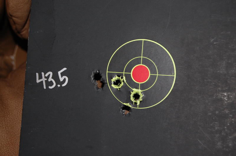

For simplicity's sake, I would load up 20-30 of those 45'ers and stretch it out to 200-300yds next when possible.
Many of those loads look good. You are cleary doing a maticulous job there.
This is part of my plan. I'm taking my fireform casings and test the 3 types of bullets I have, at 300 yards. Is hard to test at different distances because, the same police range, is used for all distances, just on different days. I will sit and think what I want to do and where I want to go with this. I have another caliber, I need to do the same thing. I have an RPR, 6.5 creed, I haven't shoot yet. Thanks again for all the advice. I really appreciated.

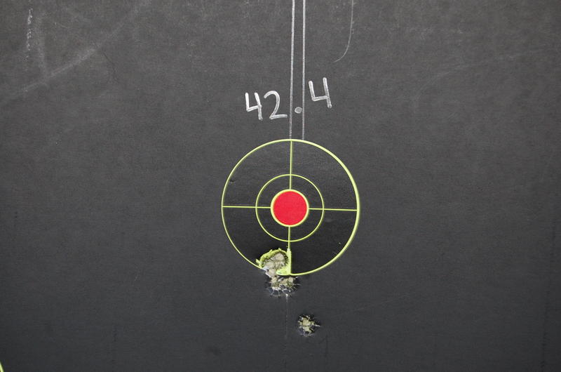

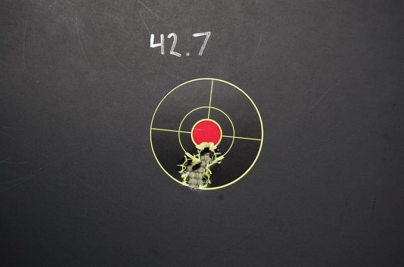

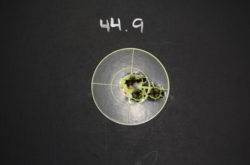

The range was open this weekend, so I test some other loads around the first loads I liked 45g and 42.5 g of varget, I did 9 more loads of 5 bullets each. There's one load, that I'm baffle with, the 44.3 load, have 3 shoots going in one hole...... or so I think. The target only show 3 holes but one hole is bigger than the other 2, telling me, that there's the possibility that more than one bullet pass trough that hole. No...I didn't shoot someone else target. The closes target to mine , was around 20 feet away, and my target was the only black target out there, so I can see the bulls-eyes better. I check the other targets on my board and none have more than 5 holes in it. I did notice, that the loads around my initial 2 numbers are good. I was able to hit good groups and since this was my second rodeo, I was not afraid of the rifle blowing up. Attachment 11143 Attachment 11144 Attachment 11145 Attachment 11146 Attachment 11147 Attachment 11148 Attachment 11149 Attachment 11150 Attachment 11151
I like the 42.7. No need to go hotter than you need. Stretch them out at 300 and see what you get.
I'd play more with 45gr. Varget. Running a weaker load is like only using half your Dick while fucking.
My best loads for my 308 is 42.5 & 45.5 using varget under a 165 gr game king. I found it to be a common occurrence looking at other guys data and it saved me a lot of time. Maybe not as fun as running various ladders....
Load development for target is diffrent for load development for hunting.
A lot is similar, but the nuances that are not is that target shooters are not concerned with terminal ballistics and muzzle energy.

I do like the 42.4, 42.5 and 42.7 , I will stick to those grains of powder for my 100-300 y shooting. The 45 gr, will be for 600+ yards, when I can go to a range that have that distance. When I get the chance, I will definitely try them at 300 y. Now I can concentrate on the 6.5 creed.
