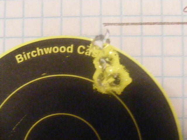

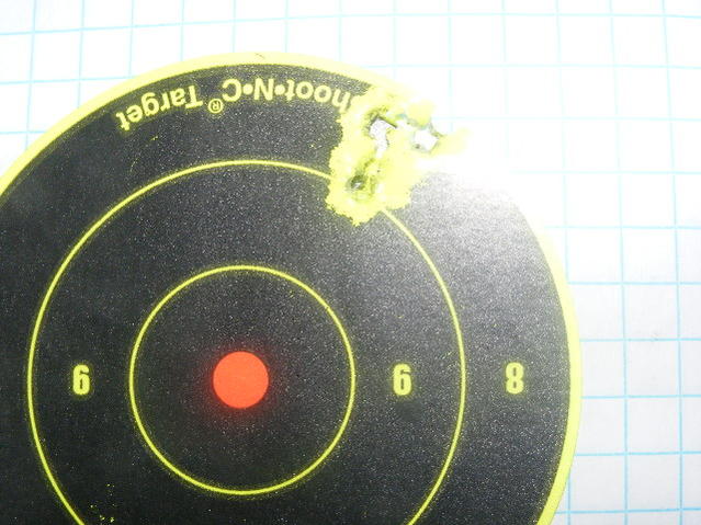

I loaded up 6 diffrent powder charges at 0.020 off the lands and headed out to the range, these were single loaded, 10 shot group 100 yds,
i'm going to shoot 2 5 shot groups next with the 24.1 and 24.5 as well as mag length and see where that takes me, primers looked good, at 0.020 from lands.. the 24.1 group had the most consistient velocity spread (29) the graph paper is 1/4" grid, and I did pull a couple of shots , comments welcome..this is out of the longest chamber rifle.
I was trying for a single load to try in a single shot, so that explains why loaded long..
Attachment 1519
Attachment 1518
Attachment 1516
I believe that rifle can do significantly better.
I could be wrong but when I looked at those groups what came to mind was . . . . "it looks like he is breathing".
Remember to break your shot during the natural respiratory pause after an exhalation.
Again, I may be wrong and if I am I apologize to you. But that is what my spontaneous thought was.

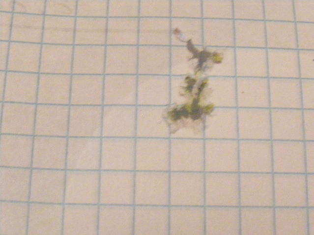

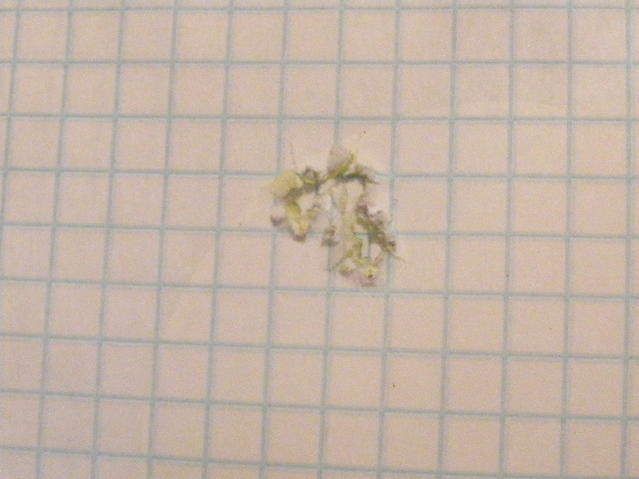

its indian error for sure..arrow is ok..
it seemed to like the 24.5 load, not much diffrent .020 or .100 off lands.. first 2 were mag length, next were loaded long.. 5 shot group
thanks to all..
these were my first reloads..
