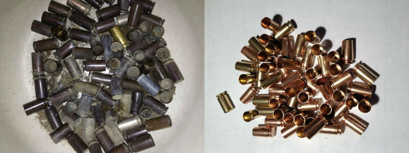

I posted this photo a long time ago and there is a thread around it that I can't currently find. You're not going to accomplish this with dry tumbling.
Attachment 17973

Never had that issue. I run them under moving water in a squirrel cage while wet and then squirrel cage them again when they are dry. Finally I run a magnet over them.

I now use a Lyman ultra sonic cleaner,rinse them in water dry with a hair dryer then run them for about 20 minutes in dry corncob media.all the primer pockets are clean also.
Most of the time I'll admit to being lazy while tumbling. By that I mean putting the brass in the tumbler with walnut screwing the lid on it, turning it on and walking away. If the media is still sharp I'll come back sooner, if not I'll come back later.
Now if I wasn't as lazy, I'd déprime the brass and wet tumble with stainless pins, lemishine and dawn. I've done it before and it does a great job and cleans the primer pockets great.

Do the primer pockets come out pretty clean after ultrasonic? I’m with Mapper about not having to dry, but I also don’t like cleaning the primer pockets. I also wouldn’t want to dry tumble after ultra sonic. If they come out of the ultra sonic cleaner with pretty clean primer pockets, that may be the best way to go and just let them air dry for a few days.
