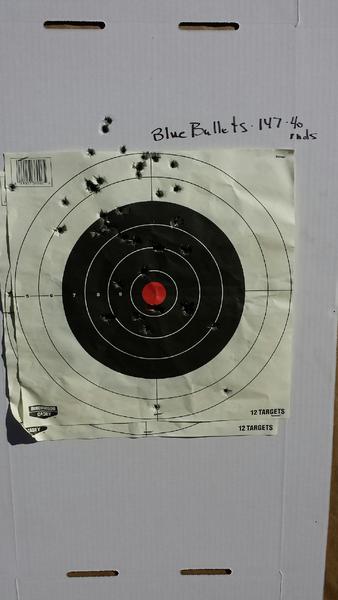

Here's my target from my first test. You may have to click it and enlarge it to see better. I know, I know I'm supposed to hit the little orange circle. (My wife pointed that one out right away. Thanks honey! Love you too!) See the patterns. It looks like the 3.2gr is the tightest. Thoughts?

Attachment 4074
You are probably not going to like this, Coach.
But what I see there is not so much an issue with grouping as a need to spend more time dry firing. You are reacting to the recoil before the pistol goes boom.
You clearly are a good shot, I wouldn't want you shooting at me, even with a 9mm. It is obvious your fundamentals are there except for that recoil aversion thing.
Here is how you can test what I am saying for yourself. Slow your trigger press down to the point it really is a surprise when the shot breaks. 'betcha you start putting lots of tiny bullets in one tiny hole.
Maybe I am completely wrong. But that is what judging JUST the image tells me. :o

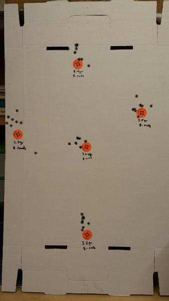

No offense. You're probably right. I have often felt I need a little more coaching and training. Seem to hit a wall now and then. That was standing free hand, bulls eye shooting. Point of aim is 6 o'clock to the orange dot. Again this is at about 30 feet. Here's my bench rest at 25yrds I did this morning. Not very impressive, but I know where it's grouping.

Attachment 4075
