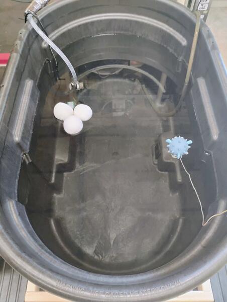

This is a full DIY functional cold plunge. I built it to experiment and am now going to make the next generation version to fit in more specific space so I need this one out of the way. You cannot build one for what I am asking. I think I have close to $600 in the build and am selling for the price of the Chiller.

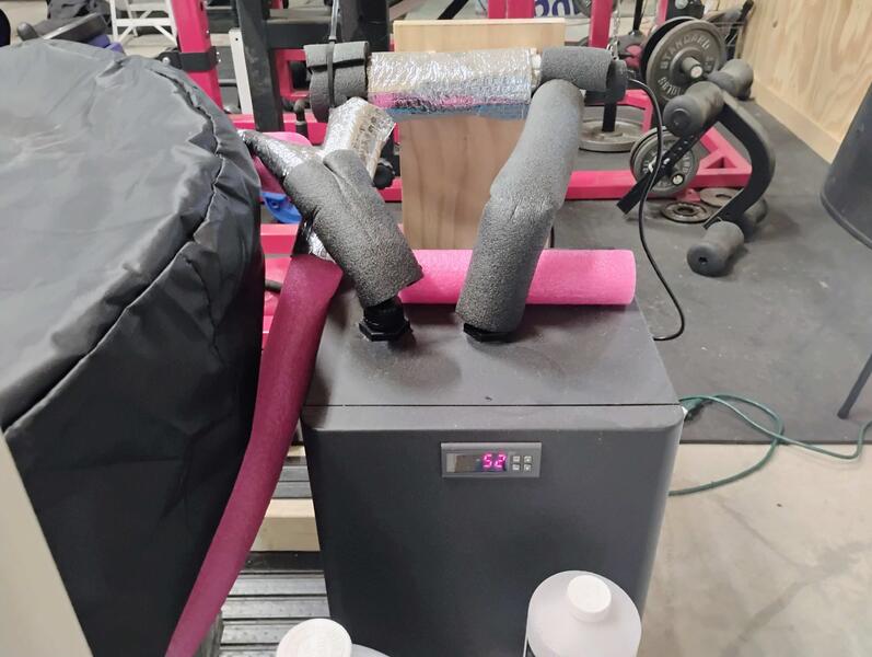

This is Rocita Aquarium Chiller ($250) cycling from a submersible pump ($25) through a line screen filter and UV light Sanitizer ($75). The tub is a foil/bubble/spray foam insulated 100g Rubbermaid Stock Tank ($120) that has had a garden hose adapter ($8) installed at the drain. Power is via a GFI strip with dual timers so you set the pump, chiller, and UV light to turn on and off as needed. It includes a cover with 1.5 hard foam insulation and the basic 2x4 stand with a towel pole. It will be plug and play with all tubing and pipes. I will throw in the chemical treatments as well.
I keep it in my temp controlled barn and it has no problem holding 52 degree temps. It may go lower, but 3:30 at that temp was giving me the relief I wanted so I've never pushed it past that.
