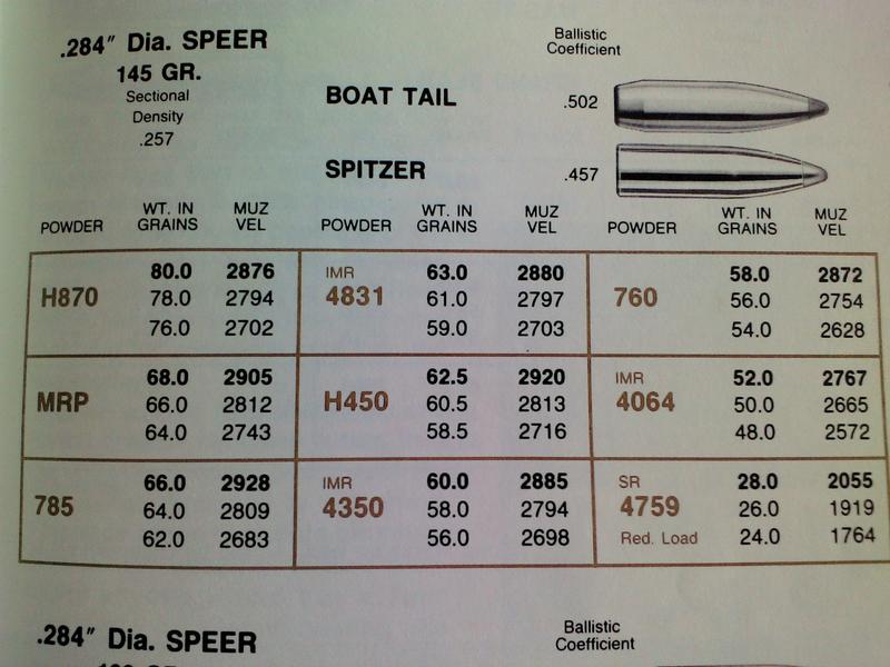

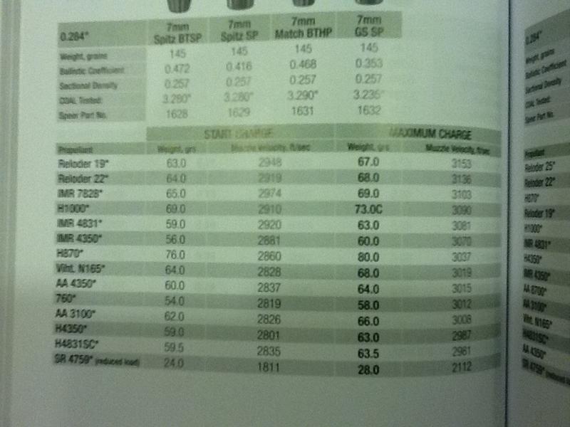

I need load data for Speer grand slams
DSH had a partial box of .284 145gr grand slams cheap. So I get to play with bullets. I'm hoping I can run 3,000 + fps using imr 4064 or imr 4831. Every book I have lists 140 & 150gr, but not 145. Common sense tells me to split the difference in max and min loads, but that's not the safe way or the correct way. But if one of you fine gentleman have the actual data that would be good...
